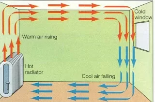

If there is any amount of heat rising over the stove there will still be a draft along the floor. The only way I know of to NOT have a draft along the floor is to heat the floor. Any time you have a localized heat source in a room there will be convective currents. [Hearth.com] Outside Air Kit
Reactions: bholler
If there is any amount of heat rising over the stove there will still be a draft along the floor. The only way I know of to NOT have a draft along the floor is to heat the floor. Any time you have a localized heat source in a room there will be convective currents. View attachment 242261
Yes there will always be cool air moving across the floor to the stove. I haven't noticed much of any difference after hooking up an oak.
