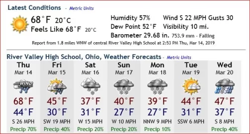

Grabbed the two charts just a bit ago to show the differences in humidity]

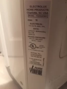

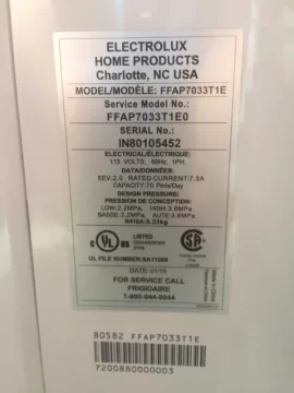

Btw, I checked my 3 units. They seem to not be listed in the drop-down, so I assume they are “ok”. You got me worried though, since I leave them on when I leave. Maybe I’ll reach out to Frigidaire, since I have 3 different models.
Thanks for bringing it to my attention.
View attachment 242418 View attachment 242419 View attachment 242420
Told the story before, forgive me. I came home one evening and was in the kitchen. Smelled something like plastic or wires burning. Traced the smell downstairs in the basement to the dehumidifier. It was close to catching fire! The whole basement stunk to high heaven. Man was I lucky this time!
Went on the net to look for info and found it was recalled. Unplugged it and sent in for the recall. Got something like $230 for it. I just went today and bought a new unit because summer is coming. I was going to get the Aprilaire unit but just didnt want to spend that much for it. I would have liked to though.
I dont see Electrolux brand on the list. You might be good.
[QUOTE="I dont see Electrolux brand on the list. You might be good.[/QUOTE]
Electrolux is Frigidaire. It appears China makes all of the models at the same factory.
Yes I see that. I cant find your units anywhere on the lists. There is no Electrolux option and if you go under Frigidaire, your models are'nt listed.
Right. That’s why Monday I’m going to reach out to them and see for sure.
