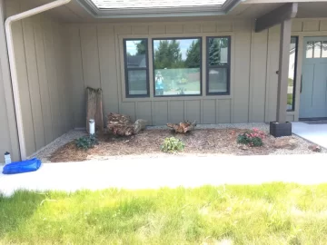

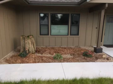

Thought I'd share this solution for an outside air pipe eyesore.
When we built our house, we installed an outside air vent pipe. It emerged in the front of the house as this was the shortest pipe run. I promised the wife we'd figure out a way to cover it up. The pictures show our stump solution.

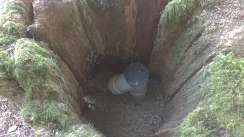

We found an old cedar stump that had rotted out but was still solid on the outside. I attached a Y fitting to the pipe and put wire mesh into the opening to prevent critters from entering. I think it turned out pretty nice.

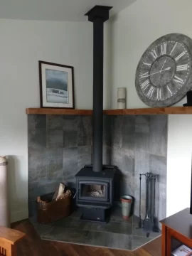

It looks great but is that for a wood stove? If so is it running up from that wood stove?
We don’t normally see air intakes coming up out of the ground. Is your stove in a basement? There are some rules about the intake opening being always lower than the firebox because it would be a bad deal if your intake pipe drafted backwards!

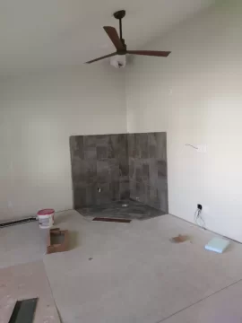

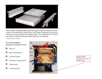

The pipe is for a wood stove. My house is built on a slab. This air pipe goes down under the slab and emerges at floor level inside the house. My stove is a PE Super 27 which sits directly over this air pipe inside. The inlet for the pipe inside of the stump is approximately 8 inches higher than the floor of the house. The firebox is approximately 12" off the floor. I can see no evidence of ash in bottom of the stove being pulled from the firebox.
This reminds me that when I was getting contractor proposals for mechanical, one of them proposed running the outside air line up through the wall and coming out 10 feet above the stove level. Now that would have had potential for draft.

Looks great so long as the inlet outside is lower than the firebox floor. Don’t let it block up with snow.

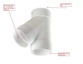

It's unclear whether that is a screen or cap on the top of the Y. It should be a cap.
I put a plug in the top of the Y. The open portion is angled downward, I doubt water will get in there.

All good. It was hard to tell from the picture.
