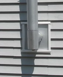

Here's mine. The J channel was not available locally in colors. Sealed with RTV silicone.
  • [Hearth.com] Outside thimble pics anybody

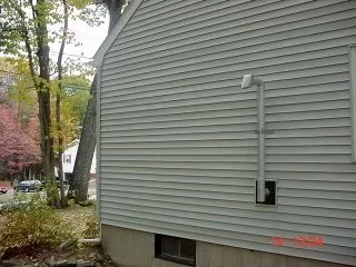

Mine is the same as kt1i but I ran my outside air supply hose through the thimble as well instead of having a 2nd hole in the wall.
