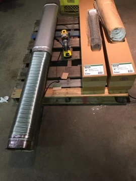

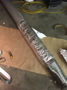

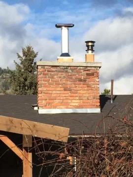

I used the duraliner oval for my insert installation too. And I have been super happy with the performance. Easy starts and strong draft on a relatively short chimney. About 15'. A high quality option IMO. I used a flex section to get through the smoke shelf/damper area and rigid for the rest. The rigid also allowed me to extend out the top of the chimney to gain more height. As I recall the duraliner instructions allow for extending the pipe out as far as you want as long as no connection is exposed.
