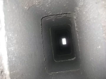

Looks like all is ok,; sort of. Its -11c here today and it snowed last night; so no rooftop today. I did check out the stove; pulled the pipe and snapped a couple blind pics up the chimney;
The bad news is I found a hole in the top of the combustion package; no wonder it seems to draft more than I thought it should. I knew this needed to be replaced though; I'm trying to wait for a month or so to see if the stove cooperates coming apart and I'll decide on the fix or replace options then. If anything I'll just use it for small fires to warm the room for the time being.

Not good news at all...
