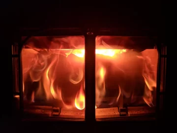

So I'm pretty sure I overfired my insert (VC Merrimack) last night and am looking for some solace.
[Hearth.com] Overfired last night
Before bed I threw a few packs of "bio-bricks" in the stove for the night burn and turned the air all the way down. Well things really got going and appeared as if I had summoned a direct portal to hell. I wasn't all that concerned at first, I've had my stove roaring pretty good before but when I shut the lights and leaned in to take a picture of the hell-fire I noticed an ever so slight glow from behind the top grate.
The area that appeared to be glowing ever so slightly was the the flue connector area. It's hard to get my IR gun to read in that area because there isn't a clear shot to it but the thermo caught a glimps of something in the 900's. The front glass are of the stove was in the 700's I think.
It was 15 degrees F outside so I opened the two doors in that room to the outside thinking the blower would draw in the cold air and help cool things off. After maybe 20 minutes the glow faded out and eventually the fired died down enough I felt comfortable going to bed.
Will she be okay?

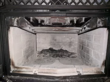

If you can allow the stove to go cold, stick your head in there and give it a look. Look for anything warped or damaged. That includes the baffle material. If all seems as it should I would chalk it up as a learning experience. I doubt that you damaged anything but it does warrant a good look over.

I only left a small fire in there when I left today so by the time I get home it should be cool enough that I can look around inside for any issues. What am I looking for? Warped secondary tubes and baffle? Cracked bricks? I think that's about all I'll be able to see without taking it apart.

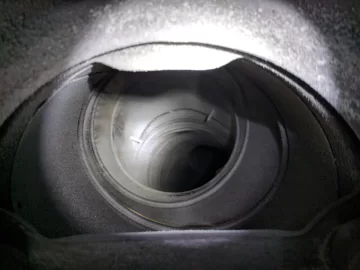

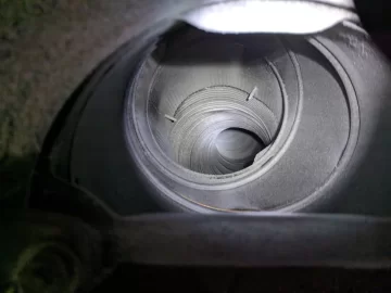

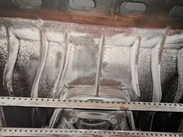

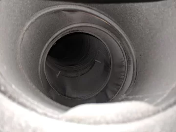

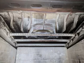

So after that night I took the baffle out and looked around. Attached some pics.
So I'm at it again tonight except without a stove full of bio bricks. Just 2-3 along with a full load of logs. I turn the lights out and sure enough as I peer through the top grate I see a faint glow. I'm thinking "what gives". The fire isn't raging out of control just exceptional secondaries which seems typical.
So I start experimenting with ways to cool things down. I start by opening the doors all the way like I've seen suggested. After a few minutes it doesn't appear to be helping, still the glow persists. I move on the plan B and go out and grab a large green split and cram it in the stove and turn the blower to high. Only now do I see the glow fade.
This whole time I'm reading the front glass area at around 650-700. There really isn't a practical place other than that to read temps on this stove. If I'm lucky and aim just right through the top grate I can catch a glimpse of the top of the stove flue connector area of which I saw a quick reading of 970 but at that point the thermometer is inches away from the stove so I don't know if that is throwing off the numbers because of the radiant heat. However metal starts to glow around 950 or so right so I guess maybe it is accurate.
Its beginning to seem like I can't fill this stove for say an overnight burn without overfiring.

Is there no baffle?
Ok, baffle removed for pics. Got it.
The baffle was put back in place before burning again? Just checking.
I wouldn't worry at all about the baffle glowing. But the flue should not be.

Is that some kind of adjustable elbow going from the stove to the liner? It looks like it might be coming apart..? I would get rid of that and go to a rigid welded-seam 15* or 30* elbow if possible.
I'm not entirely sure what kind of elbow is there connecting the liner to the insert but I didn't notice anything wrong with it. It didn't appear to me to be coming apart in any way. I had a licensed chimney company install the insert and while I wouldn't say they were the most meticulous bunch they got the job done. I plan on pulling the insert out this spring and giving a good look around and cleaning up the install where I see necessary.

The first thing that will get damaged IMO would be the secondary tubes. They will bow down in the center. Doesnt look like they were affected. I dont see any damage but I am not an authority on the subject. At least your flue is clean now!
