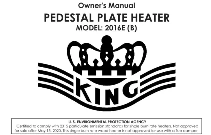

Not sure what model you have, but some stoves from that manufacturer seem to be pretty clear that you are not allowed to adjust the burn rate in any way. It says on page one of the 2016e book that you are not allowed to use a damper, too.
Their cast iron ones do appear to have primary air control.
I'd look into a new stove if you want to heat primarily with wood. That's like a car being proudly advertised as having no transmission and no brakes.

Agree with others that getting an overnight burn may be difficult w/o air control. And it does say no damper (most likely because it otherwise will exceed emissions). On the other hand they give a spec of 0.05 for draft with no upper limit except to say short burns and excessive temps indicate too much draft.
How tall is the chimney? If you can't change out the stove, get a reading on your draft. If it's not around 0.05 I would put a damper in it. Anything else is unsafe IMO.
