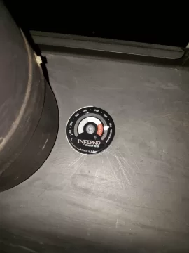

What temperature is considered over firing? [Hearth.com] OverfiringThis is the temp of my stove right now. The thermometer is located on top of the stove above the door. Is this the right place to put it?
Honestly I don't know. The guy who cleaned my chimney gave it to me. I am new to woodstoves
Yes that is a stovepipe Thermometer. Either put it on the stovepipe 12-18" up from collar or disregard the colored sections and just pay attention to temperature number.
And if relying just on the number then you're good up to 700
I have an insert so I can't put it on the stove pipe. I thought once I was in the red at 500 I was over firing. If I can go to 700 without causing any problems to the stove or liner that would be great as it will definitely help keep the house warmer

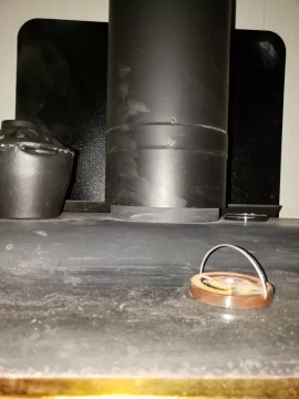

This is a stove top thermometer. I got it on Amazon. Put it on the hottest part of your stove, the hottest part on mine is near the chimney. Just took that pic, had a good fire going and looked at it, saw it was a little hot so I turned the air back a bit. Best option is a probe thermometer that goes into the chimney, especially if you are using double wall pipe

If that spot is for sure the hottest on the stove face, being an insert keep it there and just read the numbers. No colors, no words. Just numbers.
Safe to go to 650. Gice yourself some room for overfire.

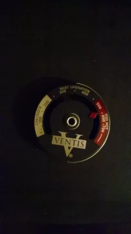

Wrong thermo for where you're reading.
Yeah mine specifically says "stovetop" and that's where she sits. The Ventis with the big V under it says nothing.

The temperature range is different on a stove top thermometer. If you go by the overfire and burn zone. If you go by the actual degrees, it doesnt matter which one you use
