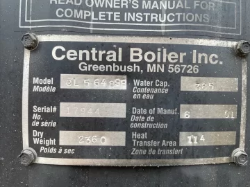

The model is CL5648SB. The metal plate indicates it was manufactured in June 2001. It appears to have a huge firebox (it indicates the heat transfer area is 114) and a water capacity of 385 (I assume this is gallons). The solenoid opens the damper when the water temp hits somewhere in the 150s. That's about all I know about the machine. The former owner provided an owner's manual and showed me two valves to turn on for water flow when the machine was operating. I don't know how to set the water temperature on this model or if I even can.

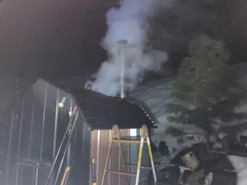

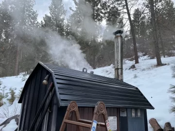

I have been experiencing overheating; not always, but typically at night. I realize this isn't a pressurized system, but the amount of steam can be a bit alarming at times and occurs in temperatures below 185, often in the 170s. I could tell there wasn't a good seal on the door, so last week I replaced the rope seal. Additionally, I cleaned out the firebox and had the chimney swept. I had high hopes that my problems would be solved, but no. It also just started doing some smoke burps out of the damper door. The smoke temporarily stopped coming out of the chimney and "burped" out of the damper.

You shouldn't be seeing steam at 185. Mine has hit 190 before and I don't see any steam. Water doesn't boil until 212F at 0 PSI. Is the steam coming from the fill pipe ?

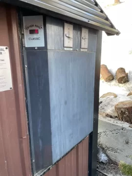

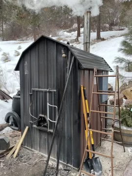

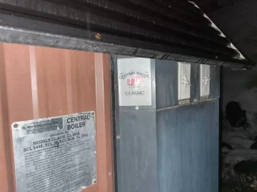

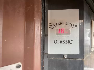

I've attached some photos of "The Beast." This is an old one, built in 2001. I have no idea how to set the temperature or whether you even can. I spoke with the closest CB dealer--he's in Montana and I'm in Idaho. He suggested trying a new pump (I ordered one from him) and possibly a Heat Trac to replace current LED. As we explored that idea further, it doesn't appear there is a replacement or after market part for this unit's LED.
As for the non-sealed damper door, if no air at all can get through when the damper is closed, wouldn't the fire suffocate?
As for reducing the amount of wood overnight, I have no problem using less wood. I'm amazed how expensive it is in the Boise area. But, it does still do it during the day occasionally.
I'm looking forward to getting the new pump and seeing if that may be the cause.
