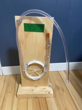

Have you ever measured the vacuum? There is a section in the install manual that goes over it. I did it after my installer left. It is very simple. There is a bolt you remove and then stick a clear hose in it (airtight). Then take other end of the hose and make a loop. Fill with some water and ,mark the level before the combustion blower is running. The measure with it running, and multiply by two.
never did that. you did that to a new stove?
Sure it's in the manual. Someone is supposed to do it. My guy was good installer, but perhaps not a pellet stove technician. There is a little adjustment POT. You could turn that up full CW. It's next to the Igniter light
