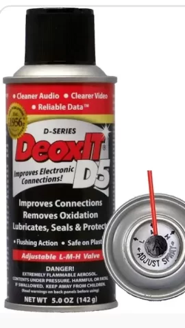

Get a can of this, a bit pricy but the best…spray it on the pots and work them back and forth, hasn’t failed me yet

CRC electronic cleaner is better to clean, De-oxit is a lubricant. Be carfull if you use De-Oxit it is possible to soften the carbon track the wiper rides on. Which could ruin the potentiometer.
I'm guessing I'll have to pop the board out and spray on the back, seeing as there's no access from the front.
