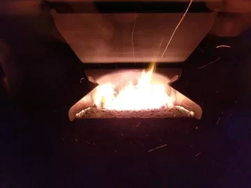

Decided to stick with my inclination and got the p35i installed today. A small error on spacing in depth, but on the whole, not too bad for an amateur.
I have to say the Harman install manual is terribly lacking in some details, like: recommending what tools might be needed, recommending Tapcons for securing the framework, and a connection guide for the user board. It seems they just assume you know what you're doing.
That said, does the position of the burn plates look right to you? Seems to me the top plate should be seated all the way down so that the channels are not visible, but I'll defer to you guys.

Yep,normal,Looks great! You just slide it back,it falls in grooves,slides to rear of stove,sits up like that in front.I think you are gonna love it!

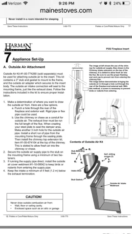

I have installed 3 Harman P35i stoves and I always recommend the optional air adapter and Harman air collar on the chimney top. After running a 3” flex liner up the chimney a few feet like the owner’s manual States, I stuff the damper shelf all above the stove with100% Fire Proof Roxul insulation. Now absolutely no warm room air goes wasted up the chimney. This saves approx 10% in the heating bill and makes the house much more cozy because the stove is not pulling air from the house to burn the fire. So far nice install. Good luck. :)
