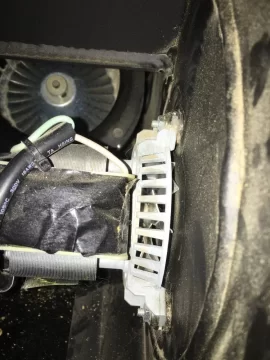

Guys. Look at the pic. This is what I'm referring to. It's at the lower right hand corner of my p43. It's a 2012 model. Isn't that the combustion blower? It had a few broken pellets in the cage and bent the fan blades to where they are now rubbing against the rear of the stove. It doesn't spin freely nor at all in test mode. I'm assuming that's why my pellets won't feed either in test mode?

Bingo. I would get a needle forceps and get the pellets out and the blades carefully bent back to position.
I would do this and would add that your motor stopped because of loose pellets getting between the stove and the hopper and lodging in your combustion motor. I use a coal bucket to load my hopper so there is no spilled pellets.
No other design has a gap between the hopper and stove body to allow pellets to fall into the works. Seen several times the room fan with pellets but usually the exhaust fan guard blocks the errant pellet or two. I know that keeping a air gap helps keep the bin cool but a simple lip could prevent falling pellets but maybe the idea is to keep the motor area cooler when in fireplace mode by letting the air naturally flow up out of the mechanical area. One can look down from the top and see the exhaust fan and on the pc45 the igniter tube
