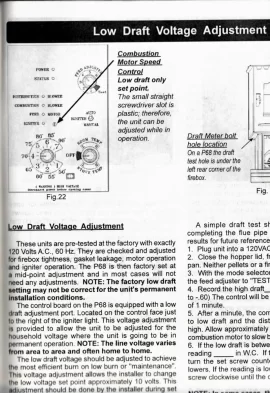

Have you adjusted the low draft screw?Your stove may not be getting enough air in low draft mode.Here is a picture of the adjustment screw on my P68. [Hearth.com] P43 Burning Dirty. Tried Everything!
Reactions: bags
