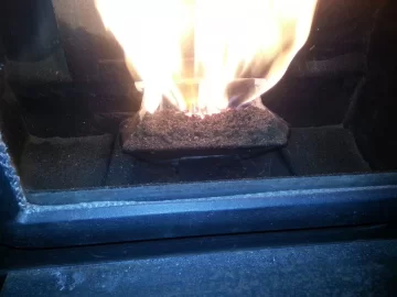

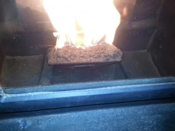

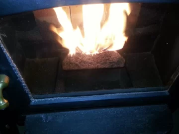

I am new to this site and I have read some great feedback from the members here so I thought I would ask about some things I have noticed with my Harman P61. This is my first year burning pellets so I am a rookie to this but I am willing to learn.

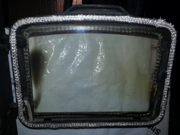

I have noticed a build up of ash in the burn pot which makes a lazy flame, I usually take a 3" spackling knife and scoop the ash out of the front of the burn pot (see pics). I clean it regularly, even the door under the burn pot. I am burning Greene Team pellets and my feed rate is set at 3-4. Is this normal for the ash to build up like that? I also have black soot that forms on the glass(see pic) where the air wash gasket is at. I have replaced the gasket but it still happens.

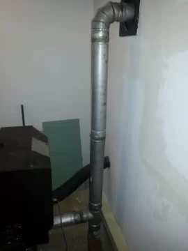

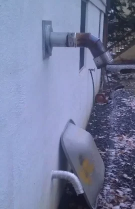

Located in a finished basement. Has an OAK, flue (see pic), I clean the blades all the time and cleaned the venting 3 days ago. After every ton the venting gets cleaned. I have burned 3 tons so far, all Greene team.

Added the pic of the outside flue, when I brush the fan I run the brush to the exhaust where the ESP is located. I have an old ice pick that I bent to clean the holes in the burn pot. The test date on the stove is March 1998. And I do scrape the carbon from the burn pot. The glass is always cleaned and the burn pot is vacuumed when it is shut down.

1. that pipe insider certainly looks like Simpson, but outside? dont think so
2. I really dont like the intake pipe sitting out there without a grating.....stuff can get in and restrict airflow

It is all Simpson venting
What is wrong with the outside pipe?
There is wire mesh in the air intake so no critters crawl in.
I dunno, but the outside pipe certainly doesnt look like simpson, tho maybe I am wrong.
wire mesh in that intake could restrict your airflow......think grate
I never liked the idea of a turn down termination,... I would turn up, go 40", then cap. .... my 2 cents
I did not want a grate against the house because I have too many bugs and spiders looking for a home. In the summer I will wrap everything leading outside with screening.
Green Teames do the same to my glass. Ash and the color your glass gets will vary with the pellets you use. Try a few different brands and see how your stove reacts. Yours looks normal to me. If it was completely blacked out, then I would worry.

I don't see anything wrong at all. Many Harman owners scrape the burnpot once ot twice a day. The soot buildup on the glass is exactly the same pattern that it builds up on mine. Now that it's getting warmer and the stove is on and off a lot, it will build up quicker. So all and all. I don't see a problem.
The op stated concerns about the development of a lazy flame. An active flame would have sharp tips, a bright orange body and a blue base. From the pictures I can make out what appears to be a blue base but the second and third pics do appear on the lazy side. Pictures can be deceiving . Video is better.
The flame is lazy when the ash builds up, when the ash is cleared away the flame looks normal (active).
