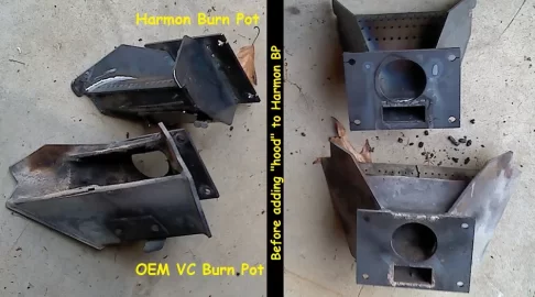

My old VC is all Harmon inside, and from 1992 first fire until Nov 2020, I never removed the burn pot. It developed some cracks at weld joints and I put a new one in, was Harman, fit perfect, and it has a opening with removable plate in front that lets me use the vacuum from below to pull air down through the holes. I had added such a hole in my original pot, with cover for same purpose. Scraping and occasional vacuum works. I did replace a gasket and welded on a flame hood to move flame away from back wall of stove burn chamber.
  • [Hearth.com] Unburnt pellets in Harman P 61
Reactions: Washed-Up
That is very interesting. I know Harman had a patient on the "Pellet Pro" but maybe not the burn pot. Or VC used the design with permission? Did/does the VC have a full pelletpro system?
