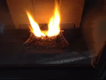

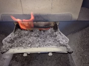

I should have taken a pic. The ash was piled unusually high and almost up against the mouth of the auger. Been running fine since. Will keep an eye on it.

Alright, just got home from work and this is what the burn pot looks like (door was open for the second pic). Fire was still going, but didn't have much room. Starting to think more and more that it went out the other night because of the ash.
