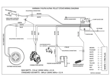

I've got a P68, well beyond warranty, with a weak blow from the front. I had one distribution blower replaced under warranty about 4 or 5 years ago. I looked through other threads and generally people say the blower should be tested in a household electrical outlet before committing to replacement. I see the blower has three female leads. My questions is how is the test done - should the leads be cut off and then the wires be stripped and then spliced on to a household plug? Or should I find three male leads and wire those to the household plug? I'm concerned about what will happen if for some reason I end up keeping this blower and all the wires have been cut up and reconnected, and then stuffed into a high heat situation with electrical tape or wire nuts.
Also, if I plug it into an outlet and it blows well, I guess that means the problem is in the circuit board? At that point, I think I'm calling a repair person.

Here is the wire diagram for you stove. Based on what I see, the green wire is a ground. The red and white go to the board. If you don't feel comfortable working with AC power then I would not attempt it and have someone that does make the proper connections. Looks to me like there are spade connectors on the combustion fan which indicates they are not real concerned about heat on the connections.
Thanks; I have it apart now, and the wires are color coded. It looks simple enough, so if I were to replace the blower, I could do it by matching color to color or just tagging where they came from. If I were to test it, I guess I would create an outlet plug with the three female leads, and then plug the blower into that, rather than cutting the leads off the blower. Anyway I cleaned up the blower and I'll see if that helps. I don't know where this thing finds all the dust.
Just get yourself an old lamp cord and install some male connectors on the end of it and connect it to the females of the blower cord. A 2 word cord is fine to use also. Ground not really needed to test it
And make sure it is disconnected from the stove and the stove is unplugged when working on it....
