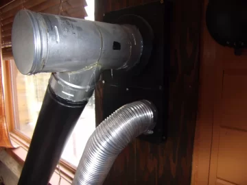

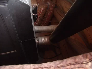

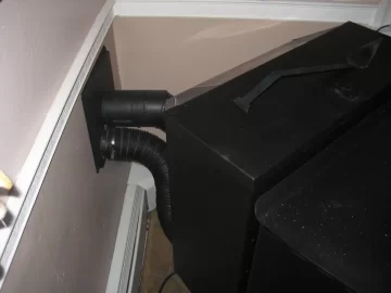

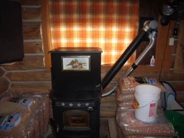

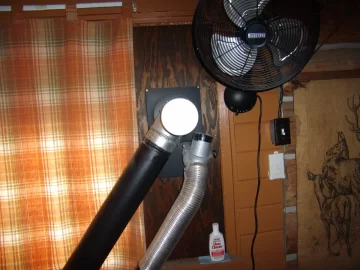

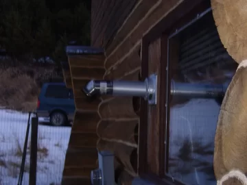

Our local Ace hardware and our Home depot stock pellet pipe. The clean out can be anywhere,as it seals when the cover is put back on. Mine is about eye level,goes down to the stove,and straight out.I did this for several reasons,but mostly because of convenience. That side of cabin has a bit if a hill,and would suck to try and shim/block a ladder,in 3-4 foot of snow,to clean it from the outside.And,being a harman,as i have said before,there is just a 90 fitting at back of stove,and when inside plate is removed,a straight shot for the vacuum cleaner. Will try to get a picture today,so it would make more sense to you.

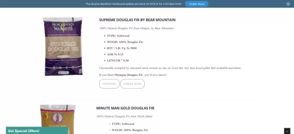

my dealer here in eastern Pa sells theses which are the best softwoods around.
pricey since there is the freight cost from Pacific northwest but nothing better than top doug firs.

bingo.......the purple bagged northern warmth are Bear Mountain in a different bag.....they are all i burn now. I used to burn Green Team pellets (which are very good) but the Bear Mountain produce about 75% LESS ash....and that is not an exaggeration.
