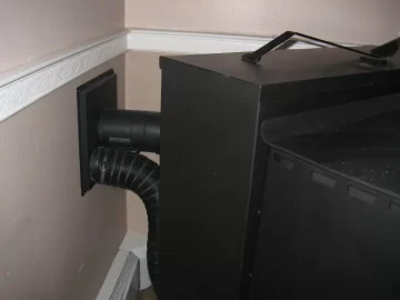

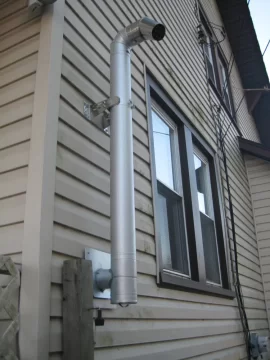

don't know if this helps but inside/outside pictures..
also OAK intake is at bottom of outside thimble..[square plate]...harman P61A..Cleanout cap at bottom..
note: when power goes out which it has, that long travel gives any smoke a route out and not into the house.
couple times a year i pull the cleanout cap, shove a 3" bristle brush horizonally thru the exhaust into the stove..
it pushes all the ash back to the stoves exhaust tunnel and then gets vacuumed from inside in seconds. lot easier..
the long vertical pipe i use a 4" round brush all the way to the top up and down and it's good to go.
I burn very good softies so the ash in the pipes is a minimal light brown powder...only time i had any actual crud was after burning a ton of BBS crappy hardwoods back in the trial and error days.
also OAK vent is at bottom of thimble..[square plate]...harman P61A..Cleanout cap at bottom..
it pushes all the ash back to the stoves exhaust tunnel and then gets vacuumed in seconds. lot easier..
View attachment 267759 View attachment 267760
That helps, thank you
