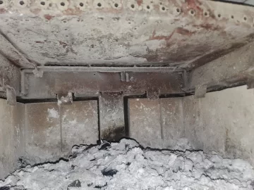

Hello. I have had this Alderlea T6 stove since 2013. It sure seems like I have lost most of my ability to control the airflow.
I have changed the door gasket with the proper PE graphite impregnated gasket. I have changed the gasket in the rear that goes under the secondary burn baffle.
What about the gasket in the bottom that goes to the secondary air box? It is item reference number 20 in the schematic. Does it need to be replaced too?
What about the item #1, secondary burn baffle kit? The baffle (I guess that is what it is called. The metal piece in the top with air holes to burn the gasses) in mine seems to be beat up and a little warped. I can see flames coming out of the rear at the top. I am assuming that is because the gasket back there isn't sealing properly.
How does that flapper thing work in the secondary air box in the bottom?
I have ordered gasket #20 and the baffle gasket and will replace them soon.
I should note that I have the ash door and a cold air kit on this stove. The ash door seals as tightly as it can, but with no gasket I am sure it leaks some air.
