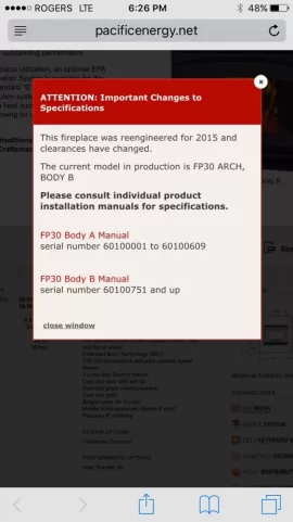

The manual will clearly state if it is a series B model on the front page. If your manual doesn't say B then it's an A model.

That does not look the same as my FP-30 arch series B. I haven't read the manual for series A, but that is where I would start if I were you. The series b manual is very good. Even for a novice like me :)
So it must be a series A. There are two provisions of top of the unit for for hooking up class B pipe. The manual only talks of gravity vents for these. I guess i dont see why it couldnt use a powered heat transfer kit but i just want to be sure before i fork out the cash for it.
The serial number will confirm if it's an A or B model. As for whether or not a remote duct kit can be used with an A series, it would be best have your dealer contact Pacific Energy and enquire.

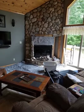

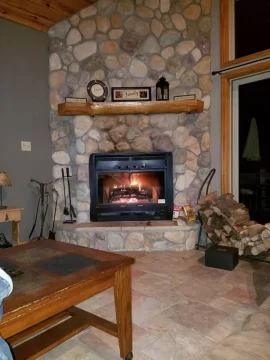

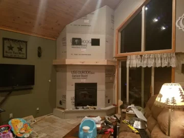

So maybe i have it figured out with tapatalk. This is where we started. Put out good heat as long as i was there to keep feeding it. Besides being inefficient, anytime we had a fire the finished basement would be cold due to the furnace not running.

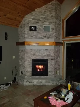

And this is where we are now. Two rows of stone were left out so I could finish the mantel but that's done now.

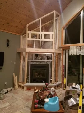

For some reason I'm not having problems loading pictures now. It was at this point I told the wife don't worry, the mess won't be that bad.

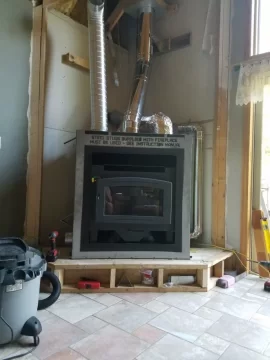

[Hearth.com] Pacific Energy fp30ar

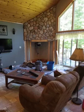

By this point she figured out I wasn't totally straightforward with her. I work in construction and even I was surprised how bad the concrete dust floated through the house. The stove room is one big room that is our family, dining, and kitchen. It dusted the whole place top to bottom.
By the time we got to this point the wife was ready for it to be done.
