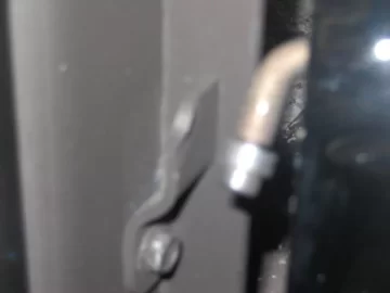

The latch on PE stoves should be TIGHT, and many times needs adjusting or the door will let air in around the sides. This can also cause you to get areas of smoke on the door glass, and have problems controlling the fire temperatures, giving borderline "runaway" situtations. We have had at least a couple of people recently having problems, and it is the first thing I thought of when reading your symptoms.
It is an easy fix fortunately, there is a tab on the door catch that merely needs to be bent in a very small amount by tapping it with a hammer. (Perhaps a PE owner can post a picture?)

Have to second what Hog & Goose appropriately brought up, the P.E. inserts are sensitive to door adjustment. I had mine installed by a guy with a reputation for being the most perfectionistic, anal retentive type east of the rockies, so I never had any trouble but I watched Hog go through a few sleepless nights here on the board til he figured out (thanks to our friends on the board) that he was leakin' air through the door. You'd think P.E. would spell this out in the owner's manual, but hey we have this forum so it's all good. Do the dollar bill test. Creosote on the glass is also a giveaway as Pacifics do a great job of self cleaning if they're set up right.

Gunners pic of his Summit door latch and hook.

Thank you for posting my pic Roo..I was going to do that this morning.
