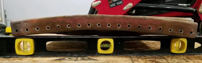

They can deflect more than that. It depends on the baffle design which has changed over the years and though similar, is not the same across all PE models. The older ones tended to bow over time with hard use, while the newer ones can sag but not bow due to stiffeners. Here is one that had to be changed due to finally starting to crack. It's from @Sodbuster's stove. I think this was from around 2014?? Maybe he can give an update on how the replacement is doing.

For some reason, our baffle of a similar vintage has not seriously sagged or bowed after 14 seasons of use.
I've burned with one similar to the one shown. If it stays up on the rails, and throws secondaries, it's doing it's job, and no biggie. All it is, is a box with jet holes and heats up and burns nasties with the superheated air, resulting in jet flames. It will not stay perfect. It's a massive mass of heavy stainless over a mass area. Sagging will happen.
I think that at one point I layed something on top of the back rail on my SIL's T5 to seal the gap a bit (in addition to making a Hogwildz donut gasket out of rope for around the secondary air tube entry.) Can't recall if I just put a piece of interam gasket along the top of the rail, or what exactly I did, but after a couple baffle removals to sweep the chimney, it's probably gone by now. The warp across the back of her baffle isn't too extreme--probably less than 1/4".
My new baffle is not warping in the front like my old one you see here. It does have a sag in the back, and we need to be careful loading it to not dislodge the baffle. It works just fine. What I can't believe is that I am still on the original door gasket!!
