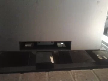

Today I pulled the insert. Covered the back handle holes with the attached plates and removed the front air cover. One of the grommets was missing on the left side fan and the fan was banging on the side of the insert when it was running. I fixed that. I have a couple of questions. There was only one screw holding the SS tubing into the insert. I have inserted two more screws that were missing. I have attached a picture. Do you recommend putting some type of sealant around the tubing where it plugs into the insert in case there is a slight leak or shouldn't I worry about it? If so what should I use?
I bought some roxul R15 insulation to insulate the tubing above the insert where it enters the chimney as well as stuffing the ash dump. Making a block plate to fit a rather large cavity above my fireplace will be a ton of work. Can I just stuff the hole really well with the roxul and avoid putting a block plate in? Please let me know what you all think.

You're probably ok at the flue collar, but if you want you could smear in some furnace cement into the gaps.
You could pack Roxul up there and it would help quite a bit. A block off plate will stop insulation from falling down and will create a better air barrier, but you are already improving upon the original installation if you want to defer the block off plate till later and see how it works with the changes done so far. Just pack it well enough so that it won't all down on the insert top. Pack as much as you can up there, evenly around the liner.
3 screws is about all you're going to get into the adapter, that should be fine. Same as I have.
Anything you put where the liner meets the stove outlet will either burn off, or crack and fall off. You should be good to go. If anything, it will suck air into the liner, not so much out, unless you get a reverse draft during cold start up, no big deal.
PUT THE BLOCK OFF PLATE IN! Do it now, and be done with it. The last thing you want to do, is pull that thing out yet again.
Remember, you can make the plate in as many pcs as you need to make it easier to install.
Some members even made a framing or cross braces out of steel angle fastened to the opening first, and then screwed the block off plate to the skeleton framing I'll call it. Great idea, that I wish I would have thought of before installing mine. Trust me, get it over with now. Roxul will help, but alone, will not stop air flow and air seal like a plate will.
Keep up the good work, you will be glad you did all of it.
