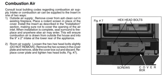

Page nine of the manual covers this. It is something you can check yourself rather than having to wait for the dealer. Is this an exterior chimney and if yes, did they install a block-off plate?

Check The manual like Begreen said. Remove the room air box cover. If you are using that. If not you have an OAK ?

The first thing to check is to make sure the room air cover is removed if there is no outside air connection (OAK) to the stove. Without an oak the fire will be starved for air until this plate is removed.

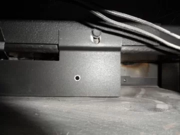

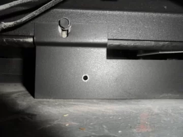

There should have been 2 plates on the back, that were to be slid over the handle holes and bolted tight to close off the holes.

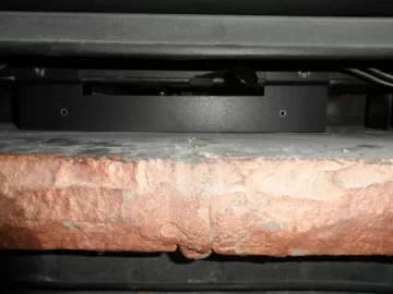

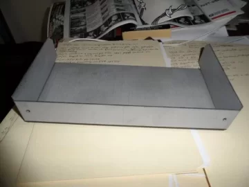

See photos. first is the front plate that has to be removed by unbolting the bolt near the top on each side. The next two photos show where the box pan behind the cover plate is bolted to(lower holes with bolts removed in photos). Last photo is the pan that needs to be removed. Then reinstall the cover plate. Now you are receiving inside air into the air intake. I have no photos of the back plate over the handles holes, I believe there is a tag on back of the casing instructing to do so.

If you look at BG's post of the manual, it shows two ways to get air to the stove: either the plate, or the OAK. If the installer left the plate on and used the OAK, then the air should be feeding through that ash dump, right? From your description, though, it sounds like they did not make any provisions for an external air source. To repeat BG's question: is the ash dump closed off with a plate or plug in the fireplace? Or did the installer remove any plate/plug, to allow air flow?

I wish I could remember, but the plates that cover the rear grab holes should have come with the stove.
It does not label them on the parts diagram, but if you look at the diagram I attached, which is out of the manual, you'll see I pointed to the plates & the holes to be covered.
Whether these let a little or a lot of hot air out of the holes, I don't know.
The best I can recollect, is the plates where on the back casing with one of the bolts through the plate and casing, the plates swung out of the way of the holes, the 2nd bolt just through the casing. The bolt through the plate was loosened, the other bolt removed, plate swung up over the hole and second bolt fastened through the plate and casing. Both bolts tightened, and that was it.
So they are either still back there swing down, or the installer took or tossed them not knowing better is my guess.
