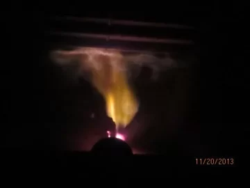

550 on top / 600 on the glass front when it's going good with nice secondaries.
First small fire after two tiny starters to bake the paint.
Little canon camera didn't capture the secondaries well.
