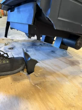

Thanks everyone for the good advice. It didn't turn out well... I used a U-ship type company and between whatever they did with it, combined with the seller not supporting well enough under the legs, the stove broke through plywood on pallet.

I would consider cutting the legs off and placing it on a stone hearth but I can't yet tell what that would involve. At a minimum it means the blower kit won't attach.
Dang... was already in love with this fine beast...

> I've seen different opinions on welding cast iron.
No doubt on that, I was going to leave a longer post on what real cast iron is and how the last place to make it in England was 25+ years ago ...
FWIW: I never would have packed it with just the skinny legs supporting the stove like that. Which is why I go for pedestal stoves.
Just MIG weld it and if you are worried about it breaking away while lit with a fire, put a support right next to it after the break, placed so that it basically just slips on and held in place by a tall U shape and weight. You will not see it from the front of the stove. I would do a test run just with the bracket and no broken leg to make sure it was taking the weight and the stove was level.
It does not look like the break effects the firebox itself and the front and rear legs are separate attachment pieces. I would weld it off the stove if possible, front and back sides, if possible. I have welded cast steel car exhaust manifolds without a problem.
Bummer, sorry to see that. AFAIK, it's cast iron. I like the idea of reinforcing the backside with a leg of pipe or square stock.
There are many types of what people refer to as "cast" iron. If you do a hardness test and look at the structure under a microscope (magnifying glass might be enough with a break) you can narrow down the type.
> a 3 year old Hearthstone Manchester
I would call them or a dealer and see about getting a new side panel. Though looking at how they are constructed inside their workshop, it is possible it is welded in place.
That being said, as long as the break did not compromise the air channel under the stove, which just looks like an air break under the air tube for the door opening, I think welding the leg on AFTER you put on a sliding support with a U channel that can not slip off would work. You might want to put a loose brass locating pin drilled through the support and side panel, BUT, I would avoid bolting it and producing stress on the hole you just drilled.

In the FWIW category, the pallet was probably let down hard by a forklift, it pulled out, stove went to the cement/floor, then another forklift came in to move it, possibly the truck driver, and broke off the leg off at ramming speed because the stove would not move with two legs through the plywood. $0.02
In my younger days I used to work in a warehouse and I was a warehouse manager, plus worked in parts at stealerships, and have moved thousands of pallets by hand. Seen more then one pallet and stuff damaged by people just dropping stuff straight down just quickly pulling the handle, double bonus points doing it while still moving and tipping over the pallet, instead of gently easing it down while stopped.
Then someone else comes in at ramming speed instead of easing it over the bottom piece of wood, hits product someone actually carefully packed and either destroys it or comes to a sudden stop on an immovable object.
It would be interesting to see if there are impact marks on the broken leg.
4x4prepper: Good thinking. Turns out there were clear signs the forklift hit the leg.
Still trying to find a welder that has confidence on welding this effectively.
Also still trying to get the broker - Uber Freight - to respond the claim for damage. Using them - Uber Freight - was a serious mistake on my part.
