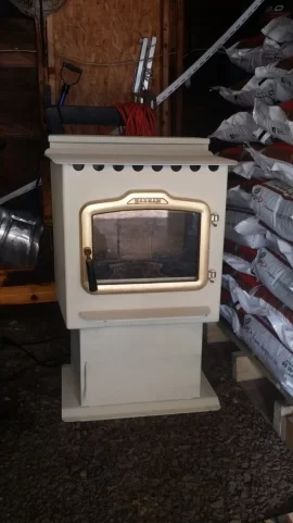

[Hearth.com] Painted the P61 So I decided to freshen the old girl up. I used stove bright Almond color and VHT high heat gold on the door. Thought Id share the beauty with you.Link Removed

Looks great! Keep us posted on how the Stove Bright holds up over the season...

I'll definitely keep an seasonal update for everyone. I did a 6 hour burn test/break in outside yesterday set on stove temp high running it at a 4 feed rate and 4 stove temp and the paint didn't discolor or anything. But only time will tell if I'll need to keep up with it!

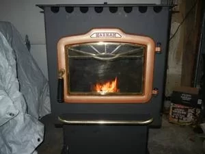

This was a project last February using Rustolium Aged Copper

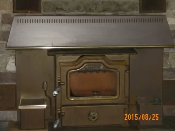

not a pellet stove i have a harman elite coal insert i repainted the stove but the fancy trim needs redoing is rustoleum ages copper safe its flashpoint is 200 degrees, just asking. harman dealer said today he may have a few pieces in stock about 300.00 . harman stopped this style trim because of discoloration which is what my problem is

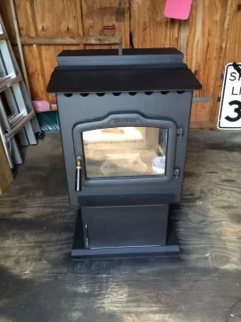

Painted my P61 yesterday. Satin Black Stove Bright. Looks so much better than it did. We bought our house and she was sitting in the humid basement. The cast iron has some surface rust and the paint on the steel was peeling. Pretty happy with how it came out.

Looks great Snocross!
Nice job!!
