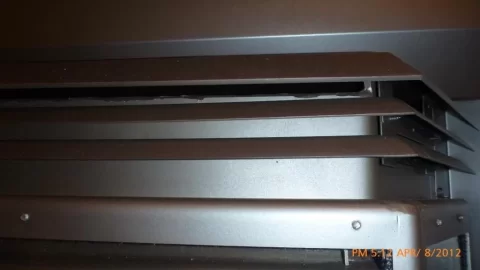

I would be really interested in seeing pics of the "jagged" areas if ya don't mind.
Pics of the jagged areas attached.
Having never bought a fireplace insert before, I didn't expect to see unfinished looking areas. For $2700 I figured edges would be straight. As mentioned above, I may be expecting too much:rolleyes: It's been known to happen.

Yeah I would be upset with that too thats BS. How is it heating the house and how long does it produce usable heat? Just to get a feel for the stoves performance, the jagged edge I just cant believe that.
Damn, I won't be happy with that either. Hope it's heating well for you. Dealing with customer service people can be a PITA, so I understand your reluctance.

glad you're osburn is working for you... did you notice anything on your stove like mine, i.e. rough looking end cuts? wondering if mine are anomalies or if it's just par for the course and I need to learn to just "take it".
Wifey and I have agreed on going full tile, no wooden mantle except just adding a bit of depth to the existing alcove... tile coming in hopefully tomorrow, will post when it comes, just for fun... then the real work begins.
I didnt have any damage or rough cuts but my stove is slightly different than yours. You have a bay front unit with loovers and those louvers can be slightly tweeked when you uncrate the stove due to it being shipped etc.The rough cuts is something I would talk to your dealer about and they should have no problem replacing them for you. Osburn is an outstanding company.
