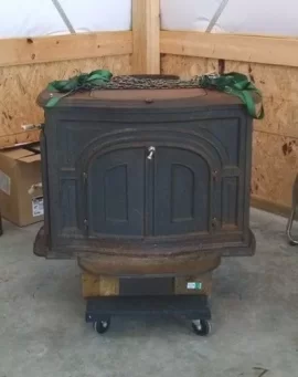

Today I got serious with the wire wheel and cleaned up the stove. It turned out better than I expected. I have decided not to use stove polish. I thought better of applying OSPHO also. I'm planning to install new gaskets, wipe it down with laquer thinner and paint with Stove Bright. Warm weather will allow me to get the garage and stove up to 60 degrees or more for paint.
Here is a before picture and several after wire wheel pictures. [Hearth.com] Painting a Defiant II with light surface rust [Hearth.com] Painting a Defiant II with light surface rust [Hearth.com] Painting a Defiant II with light surface rust [Hearth.com] Painting a Defiant II with light surface rust

not in bad shape. i not sure i would wipe it down with laquer thinner. it might smell nasty when you get a fire going in it. you might want to burn it outside for the first fire and let that stuff smoke off outside
Thanks flebec and kybishop,
I've cleaned it a bit more and started wiping it down with laquer thinner. Amazing how much black stuff comes off what looks like fairly clean surface. I intend to wipe it clean. May take a big pile cloth. I will contine the clean up until my gasket kit gets here.

Thanks LondonNeil, Going to prep for new gaskets today and get it wiped down and clean with laquer thinner. I don't have to worry about smell with first firings as the stove is going in my 30 x 40 open ceiling garage. Picture is prior to heat shield install.
My biggest hurdle at the moment is getting the stove to 60 degrees to apply the Stove Bright. I can't move mine inside a heated space. Would need to get the whole garage interior to 60. Wonder if I could just heat the stove to 60 or above for a few hours? Maybe put an elec heater inside it?
