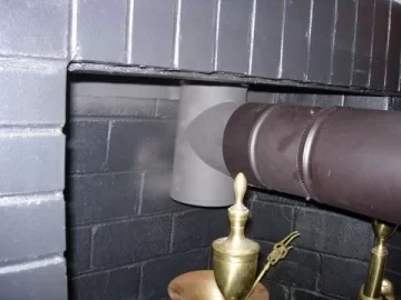

You can take a wire brush to the brick to clean them. Then you can paint the brick. We painted the brick in my fireplace, but there had never been a fire in it since the house was built in 1952. The other fireplace has seen lots of use. Here is a picture of mine. 2nd picture is a close up of the T, flash makes the color look diferent on the different metal but you can see the fire brick. Jeff

^that looks real nice painted up like that pinewoodburner ...I would have never thought of doing that. An excellent simple and elegant fix.
