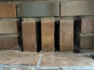

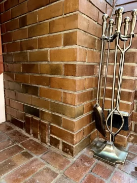

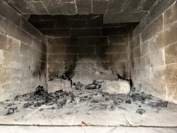

Does anyone know what the open slots in the brick are on the lower right side of the fireplace? The owner had a thin piece of wood blocking this area. It appears to be intentional in the build.

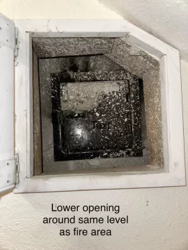

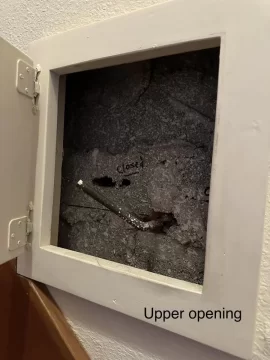

We also have two areas - one low behind it in the stairwell to our basement at the level of where the wood would seem to burn and another higher up on the backside towards the upstairs bedroom. I’m just not sure what I should be doing with these spaces … if anything.

And should I burn two separate bundles…? I’ve read that two will heat the house for upwards of 12 hours (?).

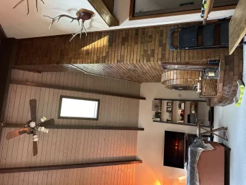

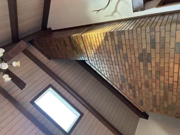

The fireplace is 85” wide and reaches two stories.
When we saw the house for sale, there wasn’t one photo of the fireplace so you can imagine our shock when we first saw it. We were stunned by its beauty and uniqueness. It really is the center of our house….but we have yet to fire it up! It’s been two years since we moved here but I’m nervous to light my first match.

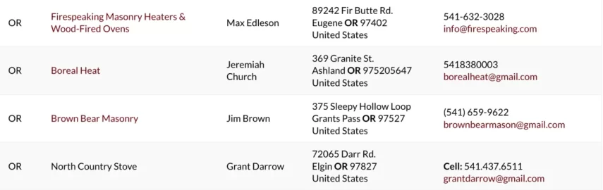

Here is a list of Oregon MHA members
Reactions: FogFirsFire

Hello FFF, I grew up close to Florence in Coos Bay, Oregon. I use to go fishing with my family on the Smith river flats. Looking at a masonry heater backwards we know it will contain certain things. It will have one or more dampers. It will have some way to get into the chambers to remove the ash. And, it will have some way to get air to the burning fire.

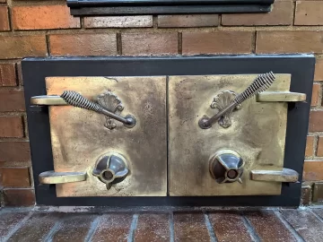

Those little round things on the doors are probably opening/closing dials to allow air in. Turn them and see if they move. You could have a lower and upper damper on this big thing. I wonder if they completely block the chimney air - they are suppose to always have a 10% opening (to prevent carbon monoxide poisoning). But in Europe they don't have this 10 % rule - they make them to completely cut off the air. And this builder was from Norway before many rules in USA.
Anyways with 2 dampers, you probably have a fire starting sequence where you get the best draft by opening one of the dampers and keeping the other one closed or partially open. What you are doing is blocking off some of the internal channels and becoming more like a fireplace until the draft gets going (tougher, especially in your coastal climate). It looks like he marked the dampers "open" & "closed".
Lastly, you have to find the access places in the brickwork where you can scoop or vacuum out the ash. Sometimes it is just bricks hiding the passage. Begreen suggested Max Edleson. He is a young curious guy. Maybe arrange for him to do an inspection, and to show you how to work this particular masonry heater. He might do it for a meal out and about in Florence.

Thank you for such a detailed reply, qwee!! Your input on the sequence for using the heater was hugely helpful. The inspector who came out talked about the spinners on the door that control airflow and they do indeed work as you described. We'll definitely reach out to Max Edleson. Thanks again!!

Totally agree, qwee. There is nothing better than returning from temps in the 100s to a cool, misty 65. Ha. And after ten years in Tahoe, escaping snowy winters is blessed. Thank you for the videos! I'll watch them for some insight. I am wondering if those openings in the brick on the bottom left of the MH is for getting to ash, etc as you'd mentioned.
