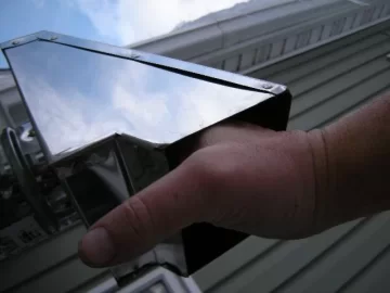

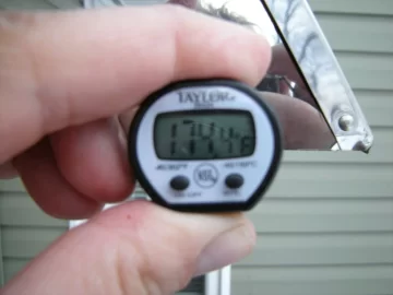

174F is very cool.
Any way you can check the temperature in the firebox?
With these 2 values we would know the efficiency.

Thanks, one of my guys at work has an infra-red thermo. I wll give it a try and report back!Thanks for the info on the distributor in MA.
An infra-red point&shoot gun thermometer will be able to do this.
Not sure how accurate they are.
I know they are not that expensive

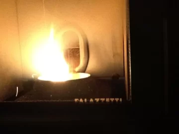

I guess you could be correct about the air wash. Being a long time owner of Quadrafire wood & pellet stoves the fresh air washed down from the top of the glass to the bottom, this stove doesn't do that. I doubt there is a seal problem, door fits tight and the stove uses oven type gaskets instead of rope gaskets. The stove is indeed awesome, can't believe how low my pellet consumption is and high high the heat output isPhildo, the airwash doesn't have to be at the top of the glass. Judging by Tays last pic, it is at the bottom of the glass.
Notice how its not cloudy at the bottom?
Look for a small slit, or gasket missing somewhere. Running a lighter, cigg, incense stick, or a candle around the bottom edge of the glass. The airwash will "suck" the smoke or flame into the gap.
