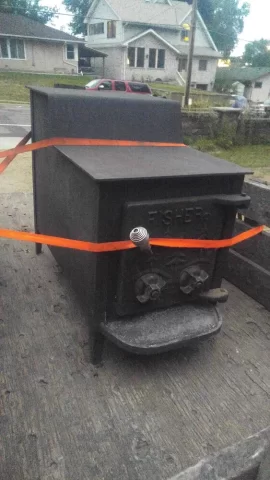

It's been a while since I posted. The wife thinks I have a Fisher addiction. I purchased a Mama Bear yesterday in near perfect condition. Back Vent. The box is a bit rough on the texture. No rust well taken care of. Looks like it was never overfired. I'm looking to restore it to pristine condition.
First what abrasive is safe to blast it. Soda, Sand, Glass bead, Corn cob, Walnut. Black onyx??? This would be for the fire box. I'm trying for a smooth finish. So I don't want to pit or rough it up.
Second what is safe for the doors. I want to try and expose the original Nickle if it is there. If it isn't I will consider re-plating it. I have a pressurized blaster and a cabinet so I am able to be versatile on the media.
I hopefully will be picking up a Grandpa bear later today if all goes well. This one is well used but from what I can tell by pics it's not damaged and will also need a full restoration. This brings me up to 5 Stoves 2 Grandpa Bears. 2 Mama Bears. One Grandma Bear. The Grandma bear was a purchase the wife made. And she say's Im addicted .. Ya right. That one is real rough. Someone decided to make it a top vent when it's a back vent. I would call that stove abuse. It has a crack on the back wall. I'm still deciding what to do to it. It will never be pristine. But with a bit of love it could be made safe to use.

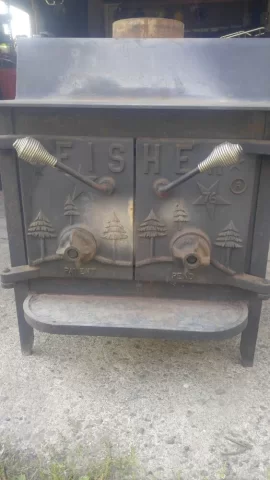

This is the old gal. 4 fin baffle.

That would be a Papa Bear.
You mean a 4 fin damper. You've been away too long. :)
Must be getting stronger if you moved that one like a Mama.
Bet you were wondering why it was so heavy for a Mama too.

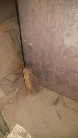

What type leg is damaged? Angle iron down the corner, weld on standard, or bolt on? They are all fixable.
Back rear angle iron was snapped off and someone bugger welded it. I can clean it up so it looks fine. Or fabricate a new leg. But it's still there. I use that one to heat the garage. When I think pristine. I think never any major damage to none at all. I have a abused grandma as well. Some nitwit tried to change it from a back draft to a top draft. . Big crack on the back. But that one has Ball feet on it. The feet are worth more than the stove. I'll send pics of both. The mama in the garage is one I've been wanting to repair for some time. I know I can make her look all pretty again. But She will never be as perfect as the day she was made. At least where the leg is concerned. I call her the walker. She moves around throughout the winter. Left to right a inch or two over the winter.

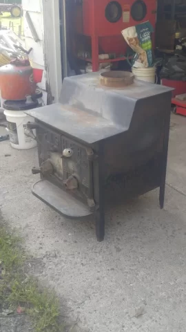

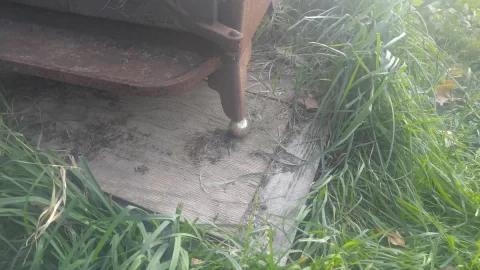

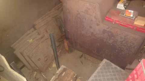

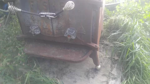

These are pics of the one I currently use in the garage . I've been wanting to spruce her up but never seem to get the time. I was wrong about angle iron being the legs. They repaired it with angle but the rest of the legs are decorative.

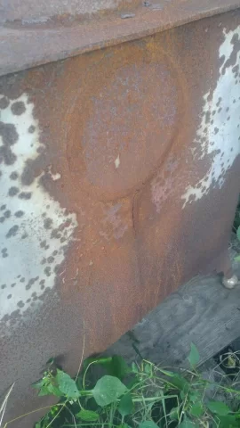

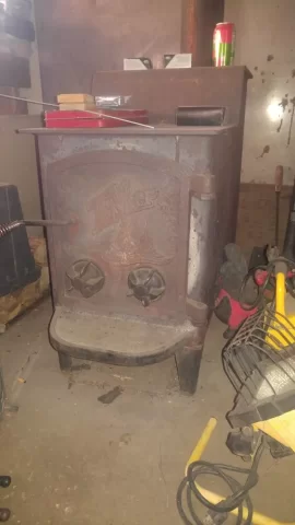

This is the one my wife got at a online auction. It's been abused. The crack on the back concerns me. Has anyone seen this weld on the back side? None of my other ones have a seam in this location.

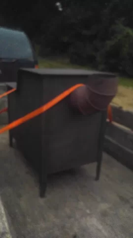

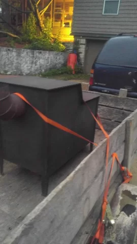

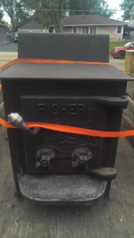

This is one I picked up this weekend. My goofy daughter sniveled and whined over a Grandpa Bear 76 model I found. She couldn't make up her mind. It got sold to someone else. This one I spotted on a trailor 2 years ago at a gas station. The gut put it at his cabin and said he would sell it to me. It took 2 years of some back and forth. After I lost the Grandpa Bear he called me out of the blue and I snatched it up. I'm still peeved about losing the 76 Grandpa but o'h well. I told her if she doesn't want it SO WHAT I'll keep it.
Welds or seam on back is not normal . Back plate should be one solid piece. Stop drill the crack with 1/8 inch drill bit, just past where the crack is visible. V groove and weld. It could be plated with 1/4 inch plate over the entire area if welds are poor.
By the doors, it looks like a Grandpa. The trees at door seam almost touch on a Grandma. This is a 1979 stove. That was the only year the new style box without angle iron corners was available with the old style flat top doors, or the new optional Cathedral arched top. This is the new style box with old doors. Designated Series III. This also has the Fireplace Leg option.
Grandma will have 5 bricks across back, Grandpa uses 6.
I believe @CamFan on this forum has those weld on standard legs.
I just measured the box and you are right. At first glance the rounded edges make it appear smaller. Box measures at 27 3/4 wide 22 1/4 deep. This matches my Grandpa 76 in the house. The weld goes from the old draft to the bottom. Could this be where the ends met up at the factory? My wire feed isn't going to get deep enough to penetrate real well. I was going to have me nephew stick weld it to see what we can do. This may sound sacrilege but I was thinking of using it to provide heat to my Hog Roaster. If it's outside there should be no issue. It would make a very unique fire box for the roaster. It beats catabolizing it. Or leaving it sit. I was considering doubling the back plate if it comes down to it. I hate to see it go to waste. But considering this would be a fairly rare stove because of transitioning from flat top to arched top. I have to consider that as well.
