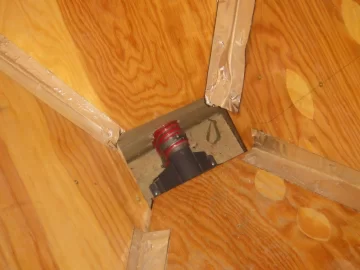

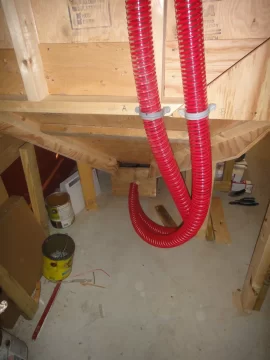

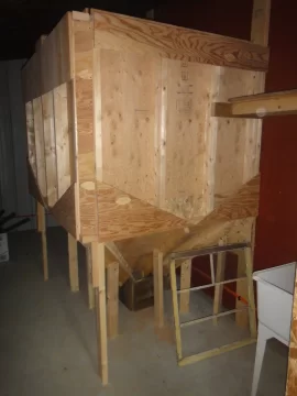

You don't necessarily need bulk pellet delivery with one of these pressurized trucks.
You can start out with manually feeding the pellet hopper.
Most pellet boilers hold 8 to 10 bags of 40 Lbs.That is 320 Lbs to 400 Lbs.
Depending the size of your house and heat load this will last 3 to 4 days before you need to refill the pellet hopper.
Another option is to build a 1 ton or 2 ton wooden pellet bin and fill this also with 40 Lb bags.
More labor intensive, but way less labor intensive then cutting&splitting wood.
