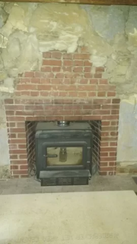

My fireplace used to be an old open cooking fireplace dating from the late 1700's. Later, a brick firebox was built inside the larger opening. They put lath and plaster over that entire wall.
I've torn down the plaster and lath, and see the mortar work between the bricks, that was intended to be hidden, looks very porous.
I need to make sure I'm not just sucking all the hot air up into the chimney through the porous brickwork. I was thinking I should try to airseal it. Parging is the only way I can think of to do this. It's right above the fireplace insert, which is attached to a top sealed chimney liner.
If I parge, is there something special I should add to the mortar? Is there another solution to this?

Thanks Simon. I was up in there when I installed the liner and stove. There's a smoke shelf made out of bricks that angles up and back towards the outside, but above that, it's hard to say. The heat is going somewhere, I'm guessing this area is one of the culprits.

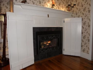

Why not remove all of that "modern" brickwork, and get it back to original? Mine was built in, identically to yours, and that's what I did.
In case you need some inspiration...

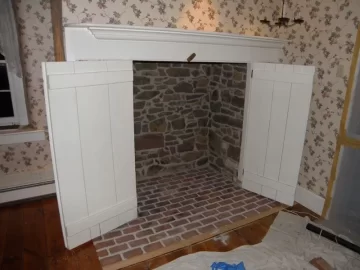

Before:
[Hearth.com] Parging

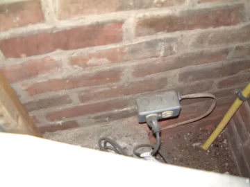

Behind the stove... brick firebox like yours:
[Hearth.com] Parging [Hearth.com] Parging

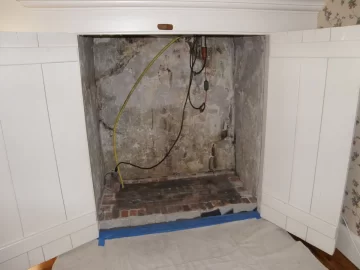

Removed framed surround and brick firebox:

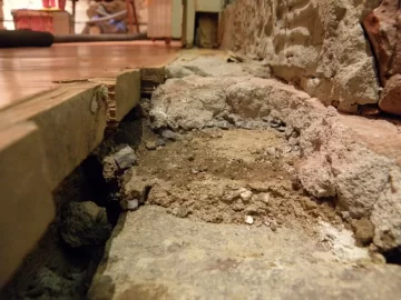

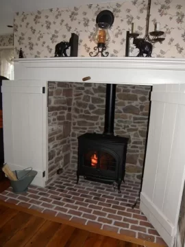

Cut back old flooring (it went right to firebox edge, as shown above), recessed new subfloor between existing joists, and laid new hearth and extension flush with old floor:

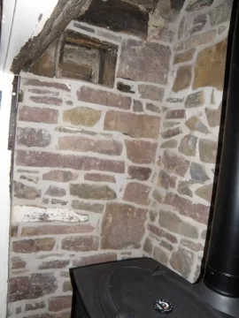

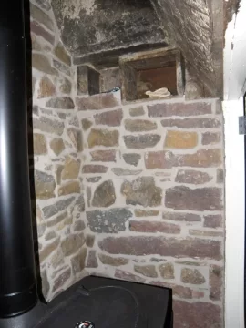

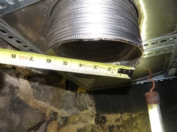

New block-off plate, liner, stove:

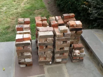

I even found some neat surprises, behind that old brick firebox:
