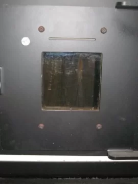

When you look at the top of the door with the window you will see a slit. Air is pulled in through the slit to help keep the window clean (not that it works well). There is a piece of metal on the inside of that slit that is flapping.

My serial number is 00201 and it was manufactured in November 2006. Here's a picture of my door.

The photo of your door is the same as mine. I just had to know about the flapper that you're talking about so I removed the top two nuts and bolts removed what I call the glass retainer, I see the piece of metal that you refer to as a flapper. Have you had yours apart? If not, check the tightness of the two bolts and nuts. When I put mine back together I didn't get the flapper positioned correctly, didn't have a air wash at all, I had to reposition the flapper. Once those bolts are tight the flapper will not slide from side to side.

When I took mine apart, it consists of three metal pieces, what I call the glass retainer, a flat piece of metal with a hole at each end and the actual piece that partially covers the slot in the door which I think is the "flapper". With the bolts tight, the "flapper" should not move from side to side or up and down, the metal is flexable enough so it will flex a tiny bit in and out. I used an xacto knife through the slot in the door to check for all movement after I tightened the bolts.
