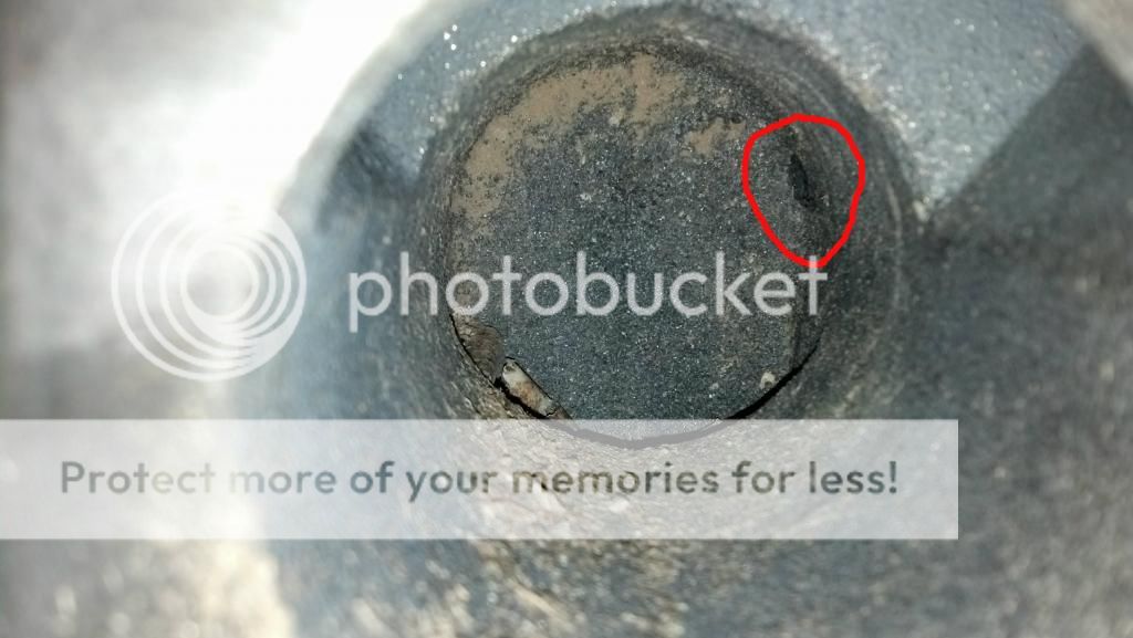

Upper Auger tube. Looks like there is a small hole in the top right corner. This normal?

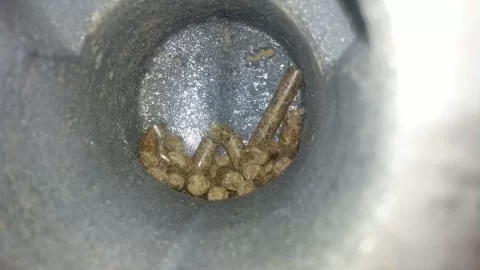

Lower Auger tube

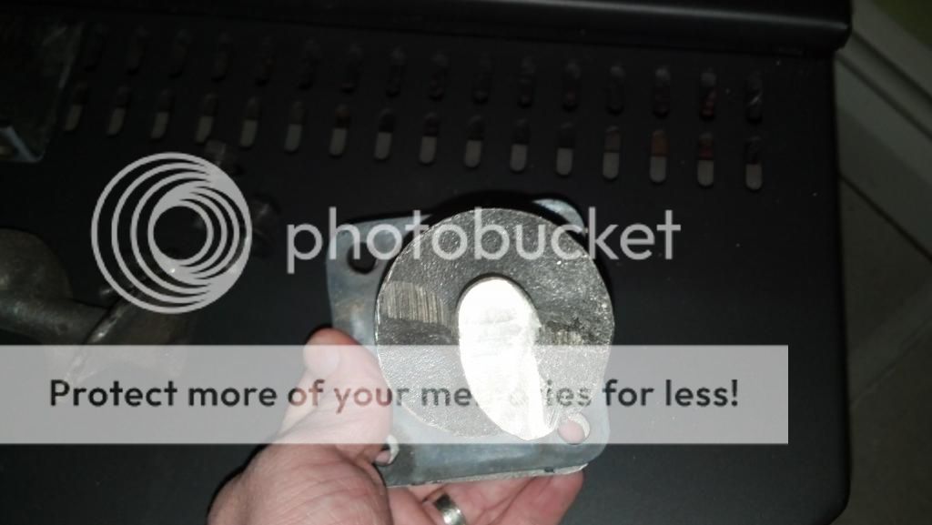

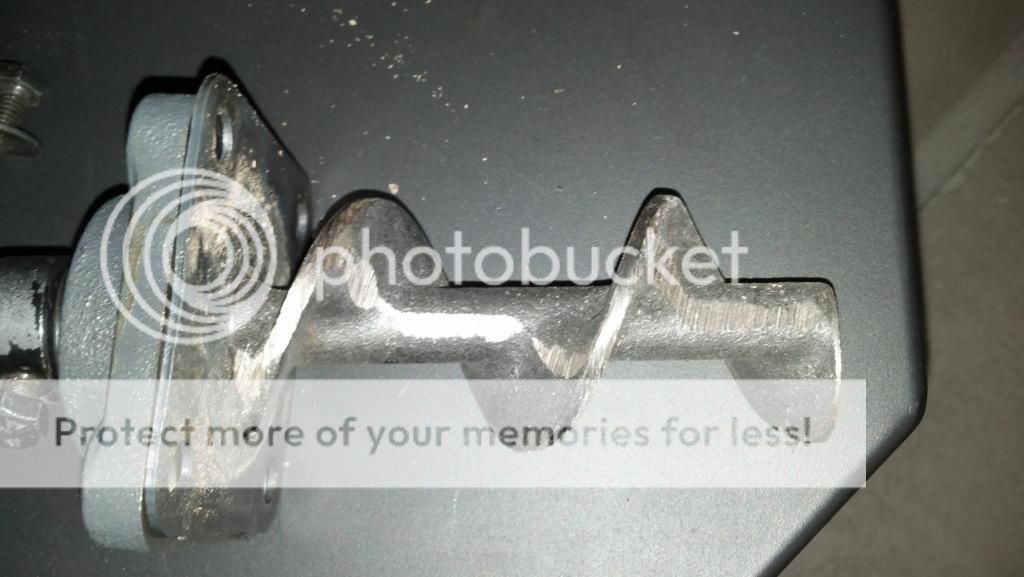

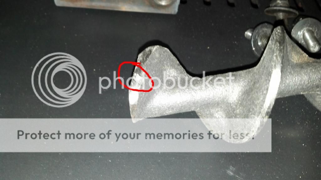

Upper Auger has a small chunk missing here.

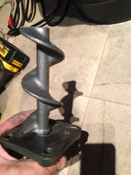

Upper Auger
[Hearth.com] PDVC upper auger jam
Try making the auger smooth with a dremel or file ect, also i greased my auger with high temp grease in the ports and seemed to help! fyi green supremes also tend to jam in my stove! Could be the culprit?
Thanks Cooper, so far everything I've run through the stove has jammed. I planned on smoothing the auger as has been suggested on here. I was just hopping it could wait until the spring.
I'd try smoothing the sharp edges of the auger flight....make them into a small radius, and see if you can get any kind of coarse steel rotary brush to go up & down that auger tube, or even a long handles wire brush.....get all that roughness off.
