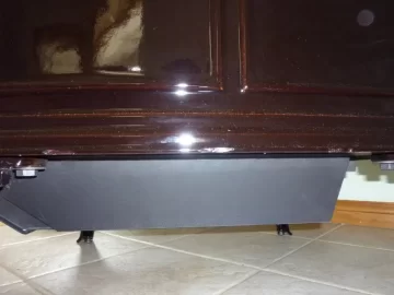

The enamel chip on the front bottom of the ash lip is barely visible in the handle pic, but way more noticeable than the side nicks, which are barely through the enamel...pic didn't turn out for some reason...I'll add it later. It's about 1.5" long.

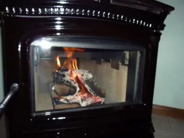

First fire was just four medium-small splits, so I could see how the stove would react before committing to a fuller firebox.
[Hearth.com] PE Alderlea T5 (continued, first full season, page3.)
Other owners are right on in their assessments; This stove is an easy breather. I'm able to start loads on a cold 15' chimney when it's in the upper 50s out (second day fire,) and still get zero smoke roll-out when I open the door. :) The smoke plate at the top of the door opening really does the job.
I just took 'er up to about 400 stove top temp the first day to begin the paint-cure process. Plenty of control over the air at 42 degrees outside. 0 degrees will be a different story of course, and I may install a second flue damper if we need more control on cold days.

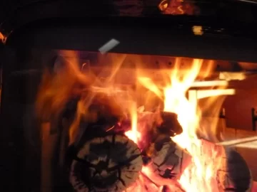

On to the next day and the second fire, with Red Elm and Red Mulberry dead-standers that I harvested within the last couple weeks behind her house.

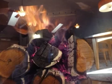

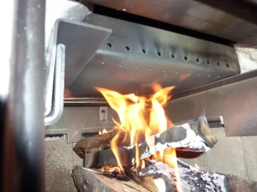

It was almost 60 out so with the weaker draft, I was able to cut the air and pretty much kill active flame on the load, even though a lot of wood was gassing.
You'll notice here that I got good secondary action on the left side of the baffle, but very little on the right side. I don't think there's a ceramic blanket on top of the baffle, so there should be nothing out of place up there that would impede secondary air flow through that side of the baffle. Not sure what is going on there; Maybe the baffle gasket has a gap on the right side, so it's pulling oxygen-depleted air from the firebox up into the right side of the baffle, therefore no secondary action on the right side of the baffle?
In these pics, you can see a slight gap between the rear bottom edge of the baffle and the rear rail, and I could see flame shooting out of there at one point. Looked like flame behind that gap between the baffle and rail at the back of the baffle, as well. I'll take the baffle out tomorrow and have a look. I may seal that gap with a flat gasket, or some interam gasket that would seal the gap. And I'll look at the baffle gasket.
There's also some insulation that you can see at the front sides of the baffle, that extends down the sides and (I think) the back of the baffle. I tried to make sure that was seated well, but couldn't really get at it too well through the flue exit, before I attached the connector pipe. Maybe I can check it from inside the firebox?

In regards to the cosmetic issues, that is something you'll have to decide it you can live with or not. Touch up paint in those areas will probably do fine. The handle looks like it was hit or bumped and the wood handle is cocked on the steel shaft. I can see the wood is cracked. I would push for a new handle assy. Not that hard to replace.

"You'll notice here that I got good secondary action on the left side of the baffle, but very little on the right side. I don't think there's a ceramic blanket on top of the baffle, so there should be nothing out of place up there that would impede secondary air flow through that side of the baffle."
If is is same as the Summit, which I think all PEs are same baffle design, just different sizes...there is a baffle board on top of the baffle, it won't impede draft unless it is somehow pushed up, hard to imagine that. Easy to pop the pipe off the outlet and look inside the outlet.
The secondaries burn what nasties are off gassing off the splits. If they are not showing on one side or the other, that merely means those splits are not offgassing yet, they will come further on during the burn when those splits are flaming & offgasing.
The side baffle gaskets look as they should, and yes they run all the way from front to back along the baffle sides.
The gap you see in the back of the baffle is actually a "bend rolled under edge flap", and actually has secondary jets inside there. so you will see a fan of secondary flames coming from there while the splits are offgasing, this again is normal. No need to pull the baffle.

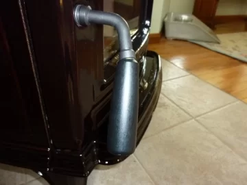

The only operational fix I see needed, is replacing the handle assy.
The handle seems to work fine. Hard to believe that thick round stock would bend, unless he really rammed the stove hard. I'm guessing maybe the handle is threaded on, and all I need it a new handle. I haven't looked at it closely yet, though. I'll do that and report back.
I think the load was burning more on the right side, and the secondaries were on the left, and the pic would seem to confirm that. That's what had me "baffled." I can't swear to it though. I'll do as begreen suggested...burn and learn. ==c
Unfortunately it's not too easy for me to pull the pipe and look into the outlet. The stove is almost the identical height to the Dutchwest she had in there, so I re-used the pipe, but I had to take off the back legs and drop the stove to get the flue collar under the bottom of the pipe. Not too big a deal, though. Before I put the pipe on, I was trying to reach down through the flue collar to the baffle side-insulation to make sure it was in place, and also used a mirror and flashlight to look. Nothing seemed to be sticking up, but thought I'd ask in case there was something I was missing.[/QUOTE]
Ah, OK. I really didn't want to pull the baffle, because I think I could conceivably need another baffle gasket, if they are as fragile as I've been hearing. Or I would have to violate patent law and fab up a pirate version of the "Hogwildz Donut." ;)

Thanks, web-ster, I'll keep that in mind. :cool: The most noticeable chip, on the ash lip, is visible in the first pic in my first post.

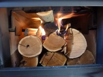

Yesterday afternoon, I crammed in a full load. I soon regretted putting a couple smaller splits in, as the stove top before long went to 600+. :oops:
The lowest burn with the air cut all the way is still too vigorous, seems to me. I think I should be able to run a lot "lazier" flame in the box and still burn clean. Less wood burned per hr. is always better. ==c Trying to figure how to post a video I took with phone but you can kinda tell from the pic how hot this thing is burning.

Last night's crammage. _g
The pipe meter is about 13" above the flue collar, and the top of the silver range is 475...blowing too much heat out the flue, the way the stove runs now on minimum air.
