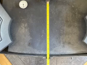

The maximum width in the center of the "circle" is 15.5" and the minimum is about 12". Here's a Lodge cast pan that measures just over 10" rim to rim for reference (I think that's a #8 based on the cooking surface diameter?)

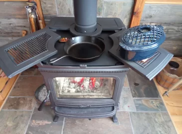

The T6 trivets swing out for a wider opening, two pots can fit, but the front to back distance is the limiting factor. A 12" skillet is the largest we have tried, but I generally don't hot fry directly on the stovetop, too messy. On top of the trivets closed one has a more moderate temperature to work with. More like medium heat on an electric stove or lower if desired.

The T6 swing out for a wider opening, two pots can fit, but the front to back distance is the limiting factor. A 12" skillet is the largest we have tried, but I generally don't hot fry directly on the stovetop, too messy. On top of the trivets closed one has a more moderate temperature to work with. More like medium heat on an electric stove or lower if desired.

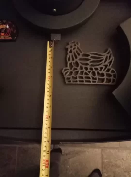

Doh! Not sure how I missed front to back as being the smaller measurement on the cooktop.
Looks like just shy of 10.5" front to back between the trivet tab doohickeys on the T5. For added versatility get yourself a cast iron stove chicken like this for a medium heat option! That being said, I'd have to agree with Begreen that cooking anything without a cover on the stove is a mess waiting to happen, but it is nice to have the option when the power goes out.

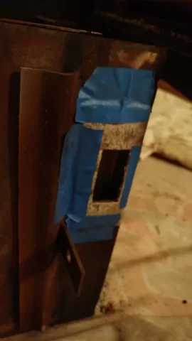

it might still be there, since you haven't taken the baffle out. It doesn't hold up well when you take the baffle out and put it back in.
Here's a pic of the one I made from interam gasket. If I'm careful when I remove the baffle, I might be able to tell if it held together or not.
If you find one of the @Hogwildz threads, he unraveled the ends of the rope gasket, then wove the ends to each other.
