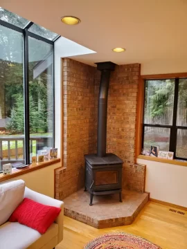

First off I'd like to say thanks to members of this board, especially begreen, for answering my questions. We just got our stove installed a few days ago, and right now it's cranking along on its first real fire after a few warmup fires... now its got a nice set of secondarys on almost-low some 45 mins after startup! And I love how it looks!
[Hearth.com] PE Alderlea T5 operating tips?
So now a few more questions if you don't mind.
What is the max height I want to stack the wood? A few inches below the top? How far from the glass should they stay?
After browsing some other threads it looks like the stovetop temp can hit 700F with no problem? But the stove top is kindof hidden... what about a temperature guage at the base of the flue? Would that work? What do you guys recommend for thermometer brand and location?
Do you folks ever use the ashpan or do you generally not bother with it?
Thanks!

That's a nice addition to the room. It fits in great there. I usually take the wood to within about an inch of the baffle, but sometimes it touches it in some spots. Keep at least an inch or two away from the glass.

Nice set-up!

By the way, it looks like your stove corners are almost touching the brick walls. (Nice to have the option of such tight clearances.) My installer did the same, though it'll require some stove shifting if I ever want to install a fan.

Great stove and looks fantastic with your setup. Totally jealous.

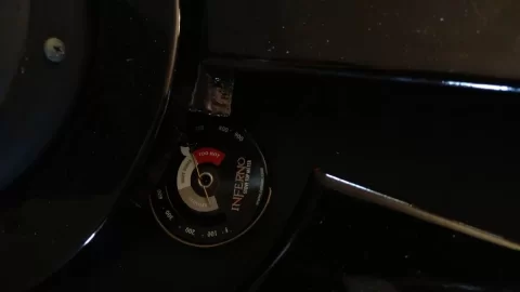

Thanks all for the for the feedback! Still learning but overall I am quite pleased with the stove! Its interesting how cutting the air back a few minutes different makes a huge difference on fire behavior. Last night I think I cut back a little too late and the stove nuked through a full load in a few hours, STT reaching 725. Today I think I cut back a minute or 2 too early and its settled into a much slower burning state with STT around 650 after I opened it back up and allowed it to recover from me closing it off too fast. I think I got it in the end though. I think this one would be great for a long term burn. A little too weak for warming up the house fast this morning but a great speed I think for overnight burns.
I placed a ST thermometer where begreen suggested.

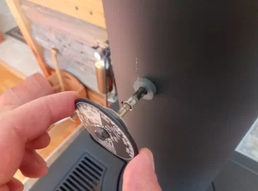

How hard are those condar probe thermometers to install? Would love to see what my stove is doing without having to get up from the couch :) Or maybe I should just learn to read the flames...
They are easy to install. You drill a 3/16" hole for the probe through both jackets, then drill out the outer jacket to 1/4" to accommodate the eyelet. Insert the eyelet then insert the probe.
Reactions: BirthofSerpents
Turns out mine is an SBI probe, but same idea. Hole, magnetic donut, small steel collar, and slide it in. (and don't forget to take it out when you sweep!)

Also do you folks ever have smoke leak out from those probe installs?

Smoke doesn't come out the tiny gap between the probe and the pipe; Draft is always pulling air from outside the pipe, into the flue through that gap.
