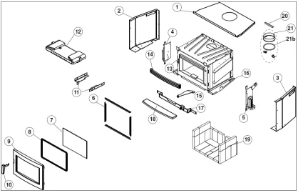

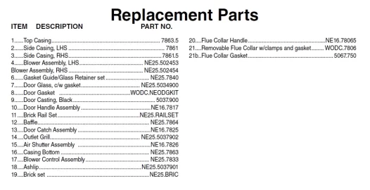

I have a PE NEO 2.5 Insert. I have read other post about user replacing the baffle gasket on their PE wood stove. I dont seems to have a baffle gasket on my NEO 2.5. I also look in the wood stove manual exploded view, and there is no baffle gasket there either. But when looking in other PE wood stove exploded view, there is a mention off a baffle gasket in it. Can someone confirm this?
Regards,
I have a NEO insert and have had my baffle out a few time, there is no gasket, post a link to the exploded view when you get a chance.
Here it is.
[Hearth.com] PE Baffle gasket [Hearth.com] PE Baffle gasket
Can you send this view? The view you posted shows no baffle gasket.

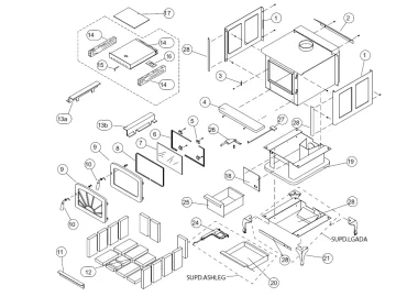

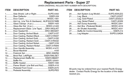

I misunderstand your request. Here`s the exploded view of the PE Super 27. As you can see, part 16 is the baffle gasket.
Yes, interesting but the 27 is a lot different than the NEO inserts, a case of different parts for different stoves....the baffle on ours just slips over the baffle intake tube so there's really no need for a gasket i suppose.
You are probably right. The NEO is a newer stove than the 27 if I am not mistaken and they probably change the design of the baffle. This confirms it.
