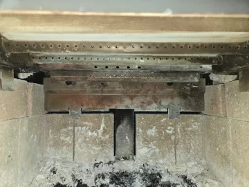

Somehow our Vista LE insert baffle fell last night. I dont think the pin was in from when we had it swept cause it was still in place. I re installed it after having to bed the pin hole on the baffle back a little.
I wasn't sure if the insulation needs to be moved above or stay where it is.
Also I read there should be a baffle gasket? I didn't see one when putting it back up.

The insulation nestles up against each side of the baffle.
