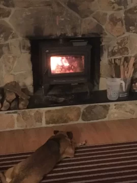

I have been doing numerous test runs the past two weeks and had great results. I guess I'm beginning to realize that once going good, these stoves can be dampered down to the lowest setting (Lowest setting designed to still allow some air into the box). I had been apprehensive to go to the lowest setting as my only experience is with old stoves, and if I shut the dampers on my old stove, there is zero air to the firebox and it chokes the fire out.
This AM I woke to a hearty bed of coals and decided to load it up. Put a few small kindling pieces on and then maybe medium splits, roughly a half full box. Took my shower, made the coffee, let the dogs out and dampered down. Had a nice roaring fire going, but maybe could have used a few more minutes of open damper. So far, even with a half full box, i should come home to enough coals to rekindle 12 hours later.
All these thoughts/concerns came about when I got it going good after work yesterday, then stuffed it to the max and set the damper at about 1/4 open. The stove seriously started throwing some heat. Nothing close to over fire, but held 650 degrees for hours on end and flue temps were 400-450.
