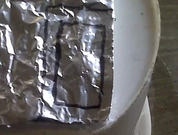

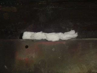

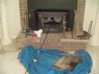

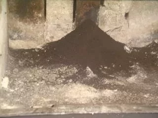

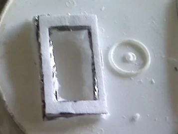

Cleaned the PE Summit from bottom to top again without even moving the stove (thank goodness). Also bought three feet of kaowool from the local fireplace store to make a new baffle gasket and plenty for furture gaskets. When I removed the old gasket, it was just a few flakes of cotton.
1. Used a baffle gasket for the PE as a outline on the kaowool blanket.
2. Cut out the new gasket using scissors.
3. Removed the foil backing on the new gasket..
4. Installed new gasket..

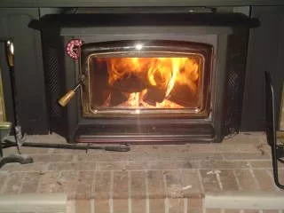

Findings after gasket install:
1. The stove runs around 8.5 hours on a full load. Last year it was around 7 hours..
2. Runs hotter. She stays steady at 650 - 675 degrees for a few hours..
3. When lighting, the fire bricks seems to ignite quicker..
4. Some sheep are fire proof..
Overall - I was skeptical at first.. but the performance is noticable after installing the new gasket compared to my last cleaning..
