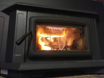

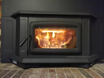

For the past 2 nights I have loaded 3-4 splits and and kept the air as low as I could without snuffing the flames. I put wood in it at 10PM, and it had candle flames until 11:45. Then the secondary burn started to happen, and it took off. The stove went from 350 degrees to 650 degrees in half an hour, and continued to accelerate. So I turned the blower up to dump heat, and it stayed at 650 for an hour until I went to bed. The same thing happened again the next night. Both nights I loaded EW. I use the biggest splits I have.
I can't control this stove! And that's NOT ok in my book. I don't think it's safe that I can't snuff the flames when I think they're getting too hot. With my old smoke dragon I could spin those air controls to clamped shut and the flame went out in seconds. This stove runs wild whenever it wants to, and if I can't figure out how to control it I'll be forced to relegate it to recreational rather than a reliable heat source. Or commit to only putting in small loads and getting up with it overnight.
Here's a couple pics of the flames. This is a 680* fire AFTER running the blower on full for half an hour. The fire box is completely engulfed in flames, with flames pouring out of every baffle plate hole.

Wow, that secondary is coming all the way to the bottom of the glass! :eek:

FWIW, that does not look like an out of control fire.
Old smoke dragons were put out of commission because they allowed wood to smolder like a smudge pot. Modern stoves do not run like them. Your stove is fine, but the operation still needs work. If you want a lower fire, close down the air sooner. I posted a sequence that may be of help. It's of a fully loaded Alderlea T6 (same firebox as the Summit). Final cruising temp was 625º with the blower off.
