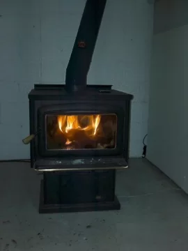

Yes it is.
And it has the ash dump and drawer, things you would miss if you opted for the insert.
  • [Hearth.com] PE Summit - Insert or Freestanding

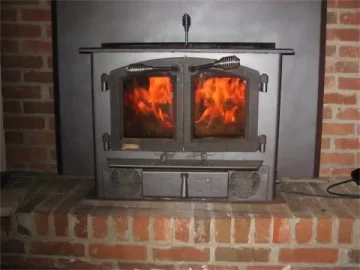

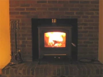

dharmama said:
BrotherBart said:
I had an insert for twenty-years that I thought was a heating beast. I replaced it last year with a free standing stove inside the fireplace with a blower and I will never own another insert again. The increase in heat released out into the room and the added heat stored in the masonry and slowly released after the fire dies down in the stove is fantastic.
What kind of insert did you have?
650 pounds of Sierra T-4500 Royale, now burning the Englander 30-NCL in the fireplace.
