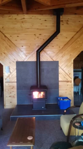

Good to hear it's working well for you. Nice setting for the stove.
Is the connector single or double-wall pipe? If single wall you will want to watch creosote buildup. Long runs of single-wall cool down the flue gases a lot.

begreen, yes it is single wall. After the first cord there was a lot of creosote. We commonly burn pine too. That being said, a lot of it was due to me not running the fire hot enough and letting the wood smoulder at start up. I've corrected those issues and things are looking much better. I've added aspen to my wood mix, which burns very hot, so much so that my door glass stays real clean. I will keep a close eye on the buildup as I've learned here!

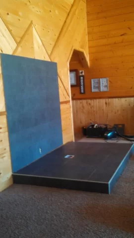

Draughtdude thanks for the complement. Nope not slate tile. It's a 1' x2' porcelin tile. It's meant to look like polished concrete. It's recified tile so we installed it without grout which is a look I've come to like. It's also about $1.99/sq ft. Gotta love inexpensive tile to class the install up.
Double-wall connector pipe will cut down that buildup. Single-wall is not recommended for runs over 6-8ft. for this reason.
First critiques, all in fun.
The upper pipe is out of plumb?
Shame to cover that gorgeous wood patterned wall!
Looks like a stove in WHoville with the pipe, but you gotta put it where ya gotta put it.

Hogwildz, Thanks! In response to your critiques...The pipe are plumb! Picture is wonky. Couldn't get away with out of plumb around my wife, she has a built in laser level! Covering up a little wood was no issue, we have nothing but wood...no drywall, no paint. It does feel a little funny covering real wood, but we like the accent. Whoville, my beverage almost shot out my nose! Putting the jog in the pipe caused a lot of stress during the planning phase, but you hit the nail on the head.
